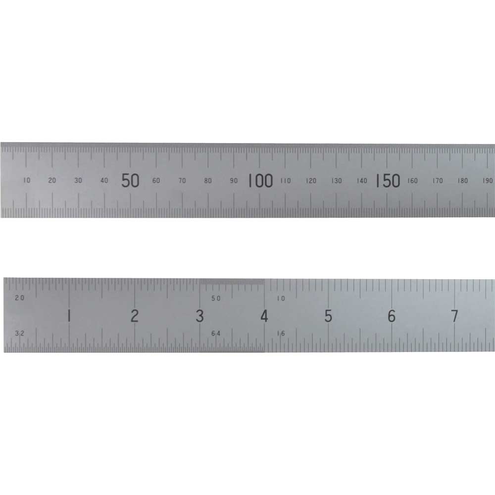

Does anyone know of a 300mm silver rule that has NO 0.5mm markers…..I found a black one but don’t like it.
The short answer is no, but if you get the Facom DELA.1051.300 (sold by a few different suppliers - that link is just the first one I found), then one of the sides is just millimetres:
The BMI tape measures have that layout as well (as long as you get the ones with 34 in the part number rather than 35, e.g. BM429341021):
Is it just me or do others get on with the 0.5 markers?
No, it's not just you. Rulers with half mm markings on are horrible.
