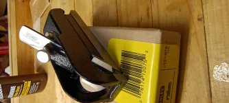

Does anyone have any knowledge of this odd little thing, which a neighbour gave me a month or two ago?
It's the Record version of the Stanley 75.
It's an interesting design. Its only virtue was its cheapness. Here's mine, bought new as a present for me back in the 90s when you could still find one made in Sheffield.
The disadvantages are that it's difficult to adjust and very uncomfortable to use.
They probably appealed to the home user who wanted a rebate plane but couldn't afford a proper one.
There's an Australian version too, branded Patsy iirc.
Thank you Andy. I have to say that it is really poorly made for Record, or else it has been really messed around with. Nothing sits properly. I started removing a big back bevel but stopped when I realised it wasn't there for planing performance but because of the shape of the casting it was sitting on. It seems to rely on tightening the screw just exactly right.
Funny thing.....the chap who gave it to me got it from a friend's estate when they died. My neighbour isn't into woodwork (great metal worker, though), and he kept on saying how sharp this little Record was. Honestly, it could barely cut paper. I don't think non-woodworkers know what "sharp" actually means.
Rightto.......I've spotted something rather fundamental. Mine arrived bevel-up. Jim's is bevel down. Which way up is the iron supposed to sit? If, as I suspect, it's bevel down, then the top of the bevel is the reference point as the damn thing doesn't lie down properly on the frog (by quite some way). That would make sharpening, particularly re-grinding, away from the business end of the iron something of a critical mission.
Bevel down. Same as mine!
Maybe you could shim the gap with sandpaper, card or sticky tape.
Very surprised if it's supposed to be bevel down. Up like any other non back iron low angle plane? I have never seen a bullnose with it down.
The bevel has a similar effect to a back iron. Also I think it will work better without any chatter with the bevel up as you'll have a better bedding surface.
It really is designed to be used bevel down, that's another of its oddities. The bed angle is about 45° rather than the usual 20° or so found on a bullnose. And the maker's name on the iron is visible when it's assembled that way up.

The 75 isn't a low angle plane. The bedding angle is about the normal 45 degrees for a bevel down plane.
Bevel up the cutting angle would be about 75 degrees, more of a scraper plane.
Oh ok, if its set at 45 and not low angle then that makes sense.... as in a moulding plane.
I've got two of these. One is mine a new one is my dad's and old. Both are similar quality and work OK for what they are. It's proven useful a few times, like cleaning up let in bits in door frames for new hinges and the such. You have to be quite heavy on the back to stop the nose digging in.
