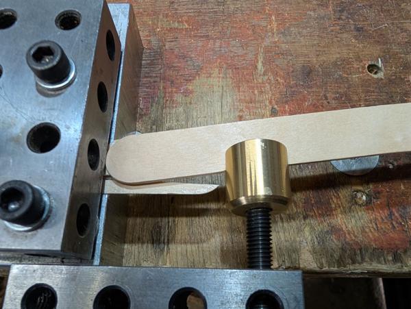

It can be used in two configurations. This is the first one:
That's for testing the joints in shear. As the screw is turned it will try to push the lollipop stick away. At some point either the lollipop stick will break or the glue joint will fail (or perhaps the jig will snap but I think that somehow unlikely 😉).

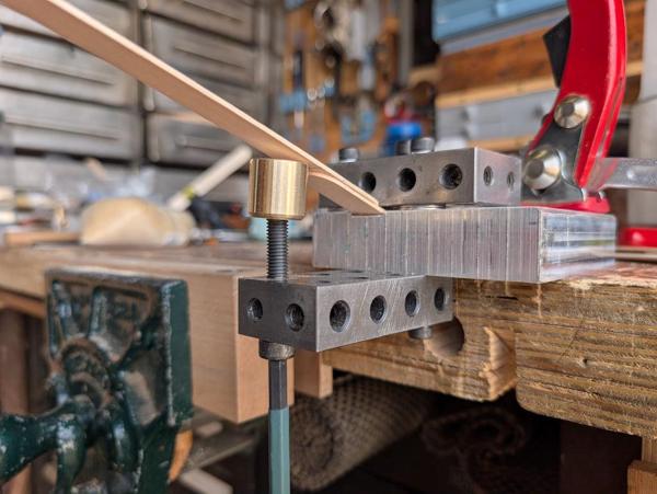

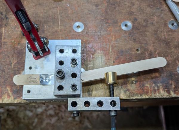

This is the second configuration:
That's for testing peel strength.
In practice, the jig won't be that ergonomic to use as torque gauges are generally designed on the assumption that screws stop moving about the time when the torque peaks. This screw will continue to rotate and that means that the gauge will also rotate and be hard to read. To deal with that I'll be using it like this, with the drive bar dropped down into one of the bench dog holes...
... and with me rotating the jig rather than the drive bar. I can see that getting boring quite quickly so I may give up and just start peeling/shearing them apart by hand to see whether the failure is glue or wood, but I thought I'd start with something slightly more metrological.

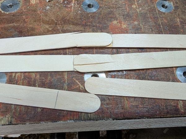

This gives an example of what happens in one of the failure modes:
As you can see, the wood has split but also the glue joint has failed in one part so that a relatively clean section of wood has separated. In the results below I've termed this a "Partial Glue Failure".
This photo shows all three of the failure modes I saw in the tests:
The top one has been called "Wood Breakage" and shows that the glue is doing a good job. The middle one is the "Partial Glue Failure" I've already mentioned and the bottom one is a complete glue failure. In a couple of tests (with the same glue) the complete glue failure happened almost immediately (hardly any force from the screw) so I dubbed those "Glue Failure (rapid)" to distinguish them.

Oooh, this was interesting: I've just done the peel testing and the results were somewhat unexpected. More to follow once I've typed them all up, but I'll share a couple of spoilers:
  1. Far more of the glues failed under a peeling load (the sort of thing you'd expect to see on a lap or panel edge joint) than failed under a shear load (that you'd expect to see trying to pull a dovetail joint apart).
  2. The old (2020 vintage) Titebond 1 survived the peel test whereas the new (bought in June 2026) Titebond 1 failed!
I agree with Lons - I'm glad you have the persistence to do this, and take pictures, and write it up for us all.
This is the set-up I used for peel testing:
In several cases, it still hadn't broken once the screw reached its end of travel so in those cases I gently pushed up on the end of the lollipop stick until it failed. In this case there were two or perhaps three failure modes. In a lot of cases, the lollipop stick snapped (Wood Breakage: hence the glue is stronger than the wood). In a lot of cases, the glue joint failed, sometimes leaving evidence of glue and in one case (TB Liquid Hide Glue) leaving a tiny bit of lollipop stick still glued down but most of the joint having failed. In one case (the weak mix of fish glue flakes), the failure happened very quickly).
The results were surprising to say the least:

Again I'll attempt to draw a few conclusions:
  1. Far more of the glue joints failed, suggesting that this was a tougher test than the shear test.
  2. The old (2020 vintage) Titebond 1 survived better than the nearly new (bought June 2026) Titebond 1!
  3. Some glues coped better with this test than the shear test (superglue, the golden coloured hide glue, the liquid fish glue and the Gorilla Polyurethane).
  4. The Polyvine Cascamite performed a bit worse than the Ureka Cascamite (two failures out of three vs one failure out of three). The Polyvine Cascamite that was mixed a bit less carefully performed better than the carefully measured ones!
  5. There are some listed above that weren't included in the shear test so I need to go back and amend that table (I've still got glued samples left). There are also some samples that I glued this morning so they can't be tested until tomorrow at the earliest.
These are the only ones that had wood breakage (i.e. no glue failures) in all tested samples in both tests:
