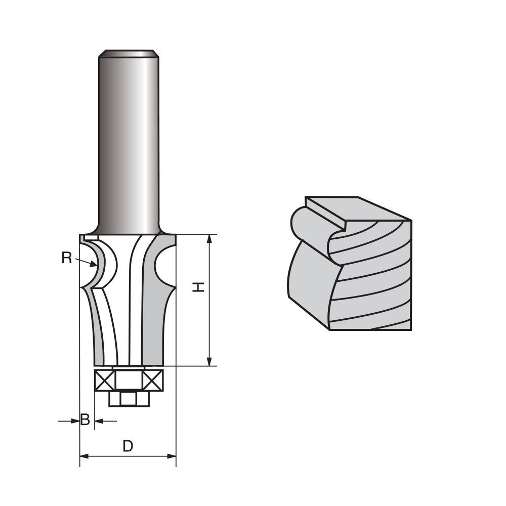

Is it one of these Rob?
I saw that one earlier Andy and it might do at a pinch; certainly the closest cutter to date...'murrican though and 1/2" shank. The one I'm after will have a 6mm shank to be used hrizontaly in a small router - Rob

I've seen these bits before, they're a slotted shaft which bits of cutter steel that has been ground to shape are clamped in with the screw at the end. It's as crude as it sounds.
Not only would it be quite dangerous to use as you're using the base of the spinning bit as a reference surface to guide it along, it wouldn't meet PUWER '98 so wouldn't be legal to sell here, not that that's ever stopped the Chinese before! You could always build an auxiliary base to the router that gives you more control than just holding on for dear life as you free-hand it along.
