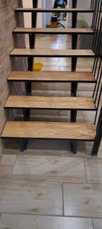

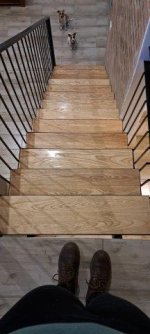

Finished and Installed
I have not seen them fitted apart from some pics, will have a closer look when I deliver the beehive rooves.
Does not look shabby at all 😊
Thank you for reading.
Phil
View attachment 28348 View attachment 28349 View attachment 28350
Phil

Sorry for drifting off topic, very snazzy stairs by the way.

Snazzy, thanks! Will see them tomorrow, and take the old camera phone with.

Excellent , they are holding up well Phil.
I looked at the strairs in the main house which has oak treads all the same grain and shade, prefer this Ash, bit more character.
