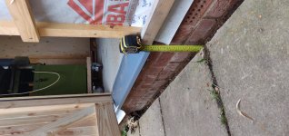

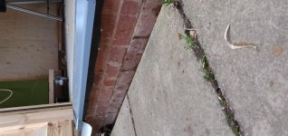

Cheers Mike, a poured slab it is then. I have attached some pics to give a bit more context and better illustrate things.
I had a few more questions on approaching this then.
1. I will cut the top two courses of brick out and this should give me a finished floor height of around 110mm from the patio slabs in. Nearly a 200mm reduction in height to what I currently have. Does this seem ok to remove the top two? Am I running a bit close to ground level? Would it be better to just remove the top course and take it down to two courses?

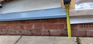

2. I purchased an off the shelf door frame and the threshold is pretty thick at 50mm. As per picture below I was going to put up shuttering and then have the slab poured to doorstep threshold height. However, would it be worth planing down the bottom face of the threshold that sits on the brick. Loosing 20mm off this will save me 20mm on concrete. Would it be worth doing this or am I just making things ore complicated? Pour slab put frame back in. Job done. Move on?
3. I would like to get a price from a local concrete contractor as they mix to volume; and post up the cost here for opinion. They do the following specs (actually they do more but these seemed most relevant based on their description)

Removing 2 courses at the threshold seems fine, so long as you end up with around 75mm of concrete thickeness.
Your choice re the door threshold. The other approach is to cut the bricks under the threshold. Whatever works.
