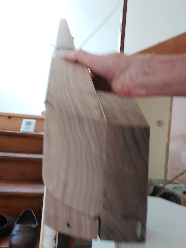

I was damned if I was going to struggle with another load of tangent drawings! I’d do this by eye.
So third attempt and which I now realise is also wrong. I need the ability to create that concave curve.
Thing is I now realise that, given the height of my spindles on the bottom step, the only transition shape is convex ie ugly. So the only thing for it is to raise the height of the spindles. But the height required also makes them look wrong.
So I’m in ‘ponder’ mode and all suggestions welcome.
