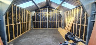

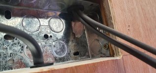

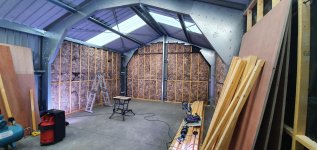

at this stage I was going to move in and start enjoying my new workshop, but decided to spend a little extra money on framing, insulation, electrical outlets and lighting. I think its one of those decisions that later on when its snowing out side and I'm nice and warm in the workshop, it would be worth the money rather than not do it and always regret it.

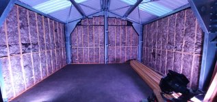

braking the workshop into sections, front and back to make it easier. electrics ran and insulation in. the insulation is also acoustic sound proofing to help with the noise of power tools not sure its needed but no half measures I guess

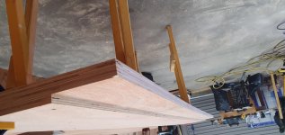

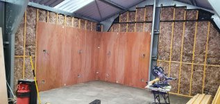

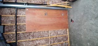

starting to board the walls was going to use plasterboard as its a hell of a lot cheaper, but this is a no half measures build so went for 12mm finish ply. taking my time as i dont want gaps between the boards chamfering the edges as I go.

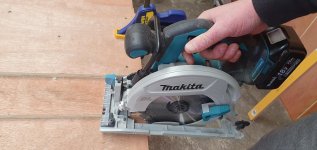

made a track for my saw so i could get the finish i was wanting, no gaps between the boards on the wall.
its handy as the left and right guides on the saw are the are different sizes so i made each side of the track to suit each side of the saw to accommodate this so I doesn't matter witch way i push the saw to make the cut.
nice straight finish cut on a long board

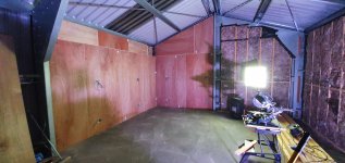

this is the stage I am at at the present
